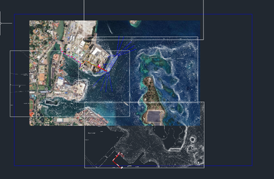

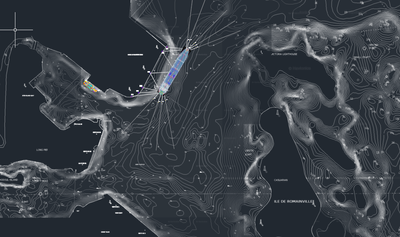

Hi Everyone
I have attached a few drawin into my main drawing, even  I have turned of image frame on all xref drawings, on main drawing tehre are still image frame frm xrefs I have tried all frame and clip off commend but it still there first imege is from my xref 2. image is from main drawing what is the reason for that and we work on sharepoint folder

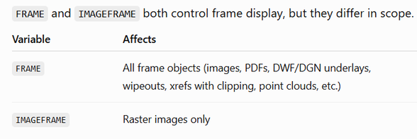

Would you try with FRAME (System Variable) = 0 . ( Regen your dwg after modifying the value)
It's controls the display and plotting of borders for images, underlays (PDF, DWF, DGN), clipped external references (Xrefs), and wipeout objects. Its master values are 0 (hidden and not plotted), 1 (visible and plotted), 2 (visible but not plotted), and 3 (mixed settings).
Imad Habash
paullimapa
so you could also set FRAME to 2 so you can see but it won't plot
