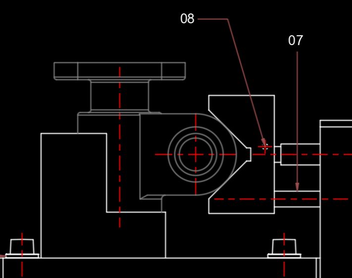

Why is my block reference not darkened. I try to edit the line weight properties but still did not change anything

Why is my block reference not darkened. I try to edit the line weight properties but still did not change anything. Is there something to do with block in place? Anybody kind to help?FBCD6385-2233-4040-95B9-2459331F6AA9.jpeg75838060-4589-409D-B56A-021F5F480A6A.jpeg

Here u go. Mind helping and inform me how u do it?

The lines INSIDE the block are predefined with an LWEIGHT setting, instead of BYBLOCK or BLYLAYER which would allow you to change the LWEIGHT outside of the block.

I have tried this but it still couldn’t work. Mind helping? The dwg is attached above. And also mind teaching me step by step?
Message 7 of 12
I have tried this too. But it didn’t work. 😞

Double-click on each block to open it in the Block Editor.
Select all objects, then in PROPERTIES command change the category LINEWEIGHT to BYBLOCK or BYLAYER.
Close the block editor an save your changes.
Repeat for each and very block in your DWG file. Each one.
That's all you need to do.

I checked your drawing and lineweight appears to be working with no issues.
A simple test you can do to be confident in how things are working in the supplied drawing is to open the block that is in the top view of your left-most assembly drawing example.  Double click it or right-click and open the block editor.
Then draw a few offensive lines across your block and notice that their lineweight property is set as BYLAYER.  Change their lineweight to .8 or something large and offensive.
Now ensure that lineweight display is turned on by setting LWDISPLAY to a value of 1.
Notice in the block editor that your new lines are indeed thicker appearing than your original gray lines (.05mm).
You should also verify for yourself that the appearance is similar outside of the block editor.
Exit the block editor and save your changes.
Again, turn on LWDISPLAY and zoom in to verify that you see a lineweight difference.
The undo command is handy so that you can reverse your changes.  Or you could close and re-open your drawing without saving.
As others have suggested, it is most appropriate to use your layers and assign lineweight for best performance and efficiency.
Set all of your entities in the drawings and in the blocks to BYLAYER and place objects on layers appropriately.  Then set a desired color, lineweight, or linetype for your layers.
I see you are using layers so some extent now but maybe try a bit more usage.

There is a SETBYLAYER command that may help with this.

Thank u so much for the detailed explanation. This really helped me alot
