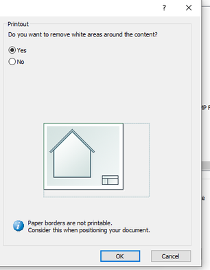

bart.tuytten
thank you for your reply.
When going to these settings, I get dialogue boxes that look
slightly different. I suppose it depends on what machine
is being used?
Though I think your suggestion corresponds to the setting below.
Yet that doesn't turn out in a good plot.
Since Covid most of plots go to .pdf. And then - if required - I make a hardcopy
from the app that I use to read them.
That is a workaround that did not solve the actual issue, but it's ok to proceed with.
Kind regards,
Bart Tuytten
