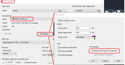

paullimapa
have you tried using PLOT command and then selecting one of AutoCAD's built-in pdf drivers like DWG to PDF.pc3 to create the pdf?
Make sure also to select the PDF Options button and check Capture fonts used in the drawing

oleh_m
Thank you for your attention to my question.
I used PDF Options but it doesn't help.
I tried disabling SHX font conversion. It helped, the text stopped going beyond the cell, but it is no longer available for selection and copying. Plus, when you hover over it, this horrible yellow window appears.
