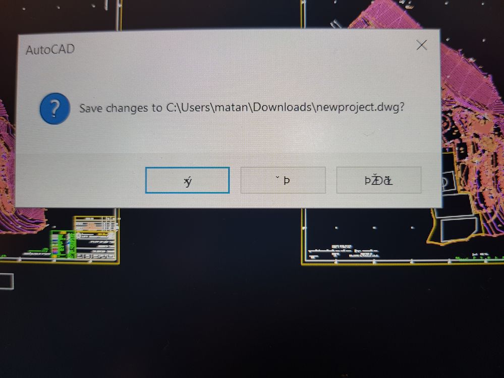

hello everyone
What's seems the reason for that?
I can't find my location of my files with this weird letters
625 Views
alex101000
Please, try:
1. Win + R -> control intl.cpl ,, 3 -> Ok
2. In the Language section of programs that do not support Unicode, click the Change system language button
3. Select the system language YOUR-LANGUAGE and click OK
4. Reboot your system
it's work!
thank you and have a wonderful day
