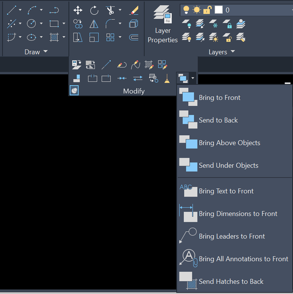

p_vanderwilk
The sewer layer is not visible on certain parts,
I have drawn a recess and filled it with a hatch color,
now the sewerage is not visible under this color.
How do I make this sewer visible? I managed to do it once but didn't write down which command that was.

Valentin_CAD
@p_vanderwilk ,
Hi Peter,
I see this is your first post. Welcome to the AutoCAD Forums
Try:
Emilio Valentin
Kent1Cooper
There's also the HATCHTOBACK command, which just pushes all Hatch patterns to the back without any other User input, avoiding the need to select the sewer lines as you would to bring them to the front with DRAWORDER.
