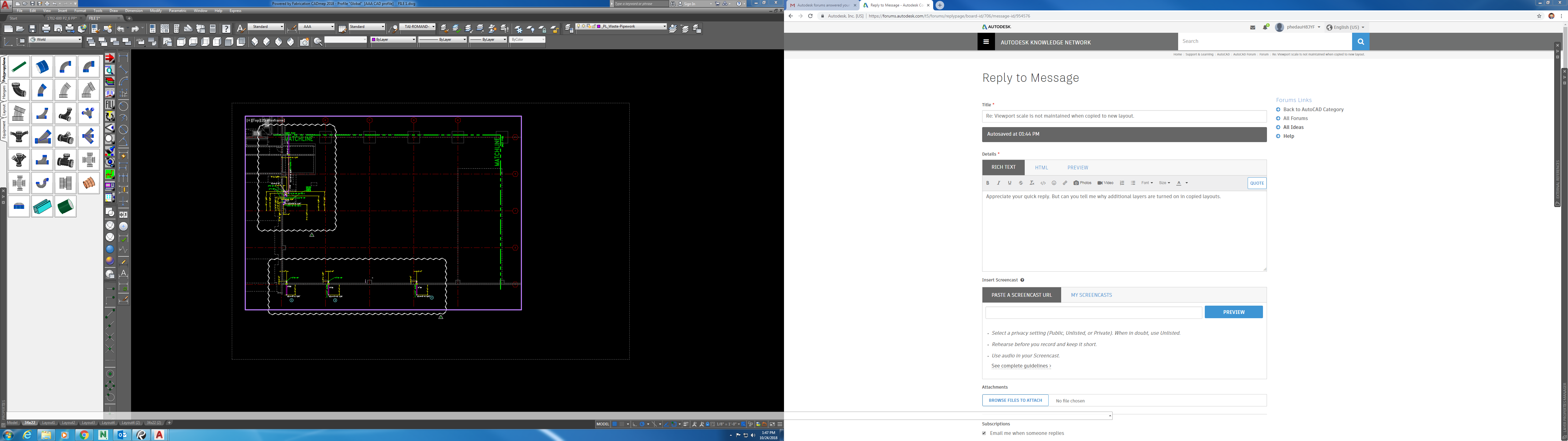

Original layoutOriginal layout
@pendean wrote:
Your locked viewport never changes it's assigned 1/8" scale when I copied it into four separate layouts in your own file, see attached.
 Appreciate your quick reply. If you take a look at attached photos, you can see how the original layout is looking but when copied, see how small it is. Also, layers are not maintained in the new layout. Layers which are turned off in the original layout are getting turned on automatically in the new one. Please address this.
Thank you.

Are you simply distracted by the unchanged paper size in the new layouts I created? I don't understand your posted images otherwise, sorry. You need to go into PAGESETUP and set the page size and plotter yourself.
I simply copied your viewport from the layout 34x22 to the 4 layouts I created: I did not spend any time creating page sizes or assigning a plotter. Your viewports never change scales, they remain at 1/8". The topic of your post.
Yes, you lose all the layer settings in the viewport: that's why the other person replying suggested you copy the entire layout and not just the viewport. Otherwise you need to create a custom layerstate for your viewport's content and reset it after each copy.
You did not include XREFs so what I see in modelspace is the only thing I see in your layout and all he new layouts.

You have not disclosed the history of your drawing. Is it yours? Did you start it from scratch or did you inherit the drawing from someone else?
This drawing has beginnings in a metric template--not an imperial one. Go to modelspace and turn on and thaw all layers. Then SELECTALL and COPY WITH BASE POINT, using 0,0 as the base point. Open a brand new, fresh imperial template and paste using 0,0 as the insertion point. Then set up your layout tabs. If you follow cut-and-paste and use an imperial template, you'll be fine.
<<Hint: when selecting a sheet size, be cognizant how Acad describes the sheet dimensions--it is width x height, not the other way around--so choose your sheet size according, i.e. W34"xH22" is ANSI-D  is landscape orientation, whereas W22"xH34" is ANSI-D in portrait. This is because the width is always first and height is always second.>>
Even though you have selected ANSI-D 22"x34" as the sheet size in plot dialog window and even though you have assigned architectural imperial scale to your viewport, and even though you go to confession on Thursdays and to church on Sundays, doesn't necessarily mean your layout tab will always plot correctly.
Note 1: Unlike modelspace where drawing units can take on various units (mm, cm, meters, in, ft, etc. or unitless) paperspace is not so forgiving. In paperspace (or on layout tab) the units are inches for imperial templates OR are millimeters for metric templates. There are no exceptions.
Note 2: You can 'trick' AutoCAD into plotting a 34mmx24mm onto a sheet sized 34"x22" when you are using a metric template and doing it this way would require you to use a metric scale bar, not imperial inches because you are physically drawing in millimeters or meters, not feet and inches. (I won't cover the trick in this post.)
