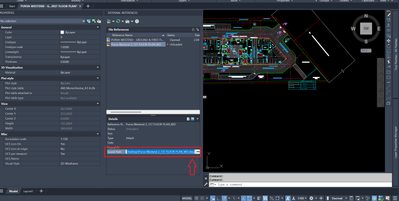

Hello @madhuryya_prakash
Begin by creating a blank drawing. Then, open the drawing from which you are unable to detach the XREF. Type XREF to open the External References palette. Locate and select the XREF that is causing the issue. Update its saved path to point to the blank drawing you created earlier—this will allow the XREF to load successfully. Once loaded, right-click on the XREF and choose Bind. Image for reference.
