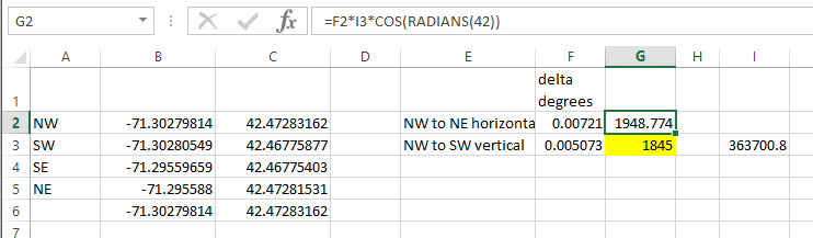

It's not clear how you are bring the shape from Google Earth into AutoCAD.
If you create a polygon shape in GE you can copy/paste it into Notepad and easily extract the latitude and longitude in decimal degrees.  From here I would copy paste the coordinates into Excel. To get the correct aspect ratio of the shape you would need to scale the shape in x by  by cos(latitude).   One you have the correct aspect ratio you can scale the shape using a know dimension to determine the scale factor.
For example, in the following I took a GE polygon that I measure in GE to be 1945' east/west by 1845' north/south.  Column F is the difference in degrees. The 1845 in cell G3 was one of the known dimensions.  The 363700.8 (cell I3) is the scale factor G3/F3. The result of 1948.774 is close to the measured distance of 1945 given the error in using the GE measure tool.
lee.minardi

Basically, i do a screen shot either from google maps or google earth & then attach the image like an xref. i find that i have an easier time working with it that way than if i if i use paste special
