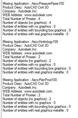

@Anonymous Have you accounted for possible customizations or drawing standards or font substitutions? Cutting and pasting should not change the style of the attributes.  The process is not just changing the font for a particular style but the style of an attribute object and perhaps the attribute definition.  Ordinary AutoCAD doesn't do that.

Try the same blocks in clean AutoCAD only drawings.  Your drawings are affected by the presence of what are missing applications at my end.  Given the level of complexity of each of these applications, project standards could be affecting how blocks behave. Each of those drawings has different applications.  Perhaps you should visit a newsgroup that supports those applications.
