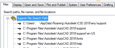

The firm I work for received a titleblock from the the architects assigned to the project. When I open the dwg i notice the font in the titleblock is almost microscopic and I'm unable to select it unless I zoom out, in which case the text appears to look normal and selectable. When I zoom back in the text goes back to being tiny and almost invisible. When I view the same file from my coworkers machine they see everything perfectly, which leads me to believe it's something with my settings.

Valentin_CAD
@bacDPF66 ,
If you place your all your fonts on a common network and add the file path to your OPTIONS > File (Tab) > Support File Search Path  (move to the top), everyone will have access to the same fonts.
Sample:
