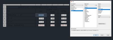

Hello to everyone,
Thank god finally found the solution to a similar problem I have.
Hope someone can solve my problem:
I have a table with Object Area Fields inside. Also I have a column sum. I would like to roundup numbers like: 82.09 to 82.10, 1.66 to 1.70, 83.03 to 83.00....
Hope someone can help me.
Thanks a lot in advance 🙂

JTBWorld
Round 83.03 to 83.00 or 84.00?
Jimmy Bergmark
JTB World - Software development and consulting for CAD and license usage reports
https://jtbworld.com
Message 12 of 15
st19675
Thank you for your fast answer Jimmy,
I need to round up  from 0.05 up or round down from 0.04 down, as for example: 73.91 to 73.90, 75.56 to 75.60, 5.25 to 5.30, etc
Thanks a LOT 🙂
Message 13 of 15
JTBWorld
That would be like this: round(A1*10)/10
Jimmy Bergmark
Message 14 of 15
st19675
Finally it worked like this:
ROUND(A1/0.05)*0.05
Thank you very much!
