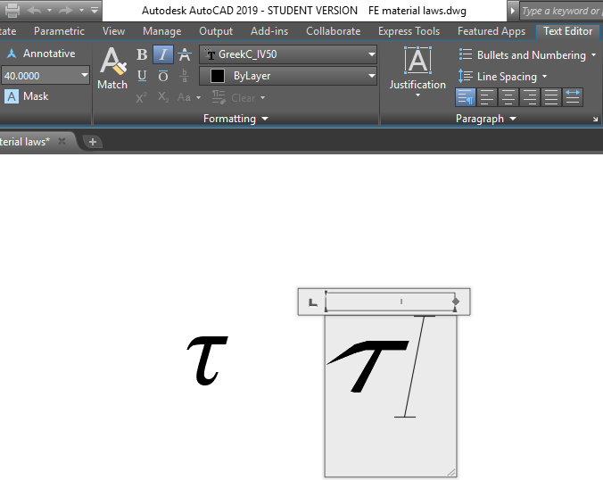

I still have problem that tau does not appear in Greek font as it appears in Times new roman font (As I want to be). Do you have any suggestions ? 2019-05-26 18_32_58-Window.png

BeKirra
My fonts look the same as what @leeminardi has (I also have "GreekS_IV25" & "GreekS_IV50").
My Windows 10 is "Enterprise" edition. What is your edition?
Your answer might answers your question. Smiley Happy
