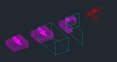

One of the things I do when I'm having a not watertight problem with surfsculpt is to create subobjects to try and located the problem area.  For example, for your part I subtracted a box from the mesh and then used surfsculpt successively on the remains from the Boolean subtract.  The box was exploded so that I could use of its sides to help define a closed surface.  The red object is a solid.
The next step is to work with part of the mesh that was not included in the successful Boolean subtract further isolating the problem area.
