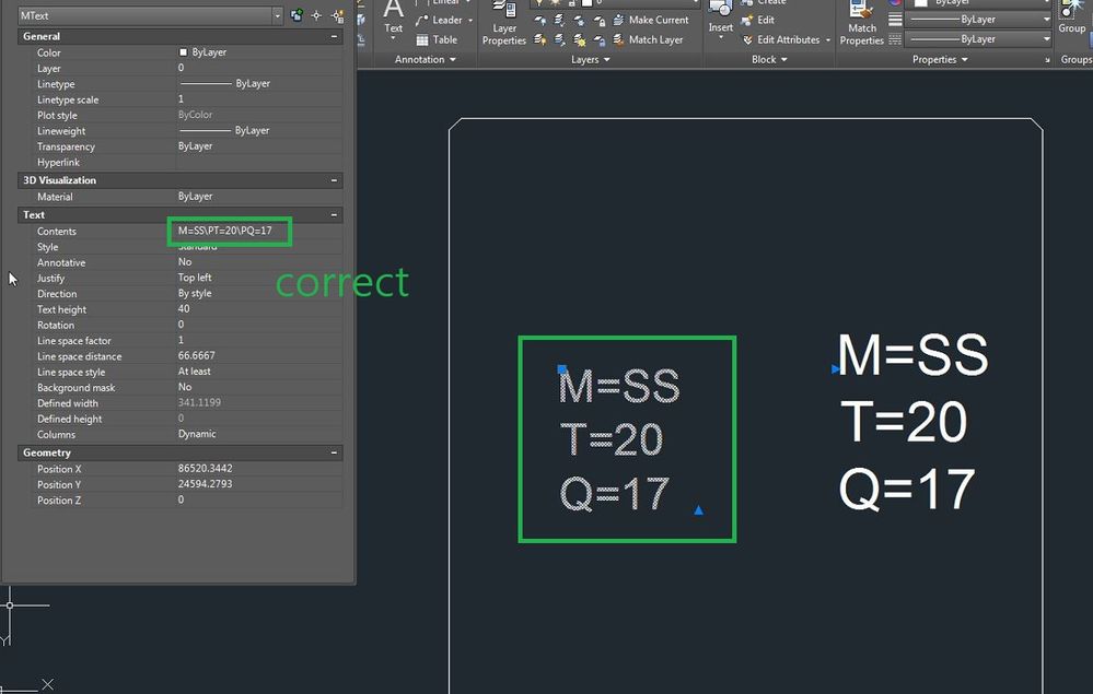

Thanks for the file. I have looked into it, and I think the text 'pxt4;' should be an expression code used in the multi-line text, same as '/P' that indicates the enter command.
If you double click the text to edit it, and place your cursor on the first and second line, the symbol showing the tab is NOT present in the ruler at the top (image solution 1 and 2 attached). However if you place your cursor on the last line there is a tab symbol (shown in image solution 3). The commands controlling this is in the paragraph dialogue launcher in the text editor ribbon (shown in image solution 4).
If you want to remove the text 'pxt4;' just drag the tab symbol at the top to the left, while your cursor is on the third line (image solution 5). The eventual text contents shall therefore not have the "undefined text" (image solution 6)
Hope this solves everything
