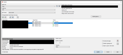

Post a screenshot of your PUBLISH command pop-up from your computer.
Do the same from the other PC.
Do the same for the ABOUT command pop-up from each seat too please.

Here's a screen of the issue as well:
It plots like this when plotting from the sheet set. Black is the size and location the sheet gets plotted.
It plots properly when using publish
My Computer:
Generated PDF size: 36 x 24 in
Other Seat:
Generated PDF Size: 36 x 24 in

Try making a proper Page Setup using the same Dwg to Pdf.pc3
When you are in you Publish window, use the ''Plotter Named in Page setup'' option and apply it to all your dwg's (instead of using Pdf Preset - Dwg to Pdf) and give that a try.
