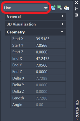

hi
i am new to autocad, pls help
i want to know how to set the property as picture number 1, currently is like picture number 2. that is a property of a line, i got from 2 diff files.  thank you

@andre_andre168 ,
Welcome to the forum!
For Picture 1, draw a Polyline.
For Picture 2, draw a Line.
If currently a line, just use PEDIT to make it a Polyline:
Emilio Valentin

@andre_andre168 ,
Consider using the FLATTEN command, or change the Z value to 0.
That usually happens when you have different "Start Z" or "End Z", as your sample shows:
Emilio Valentin
