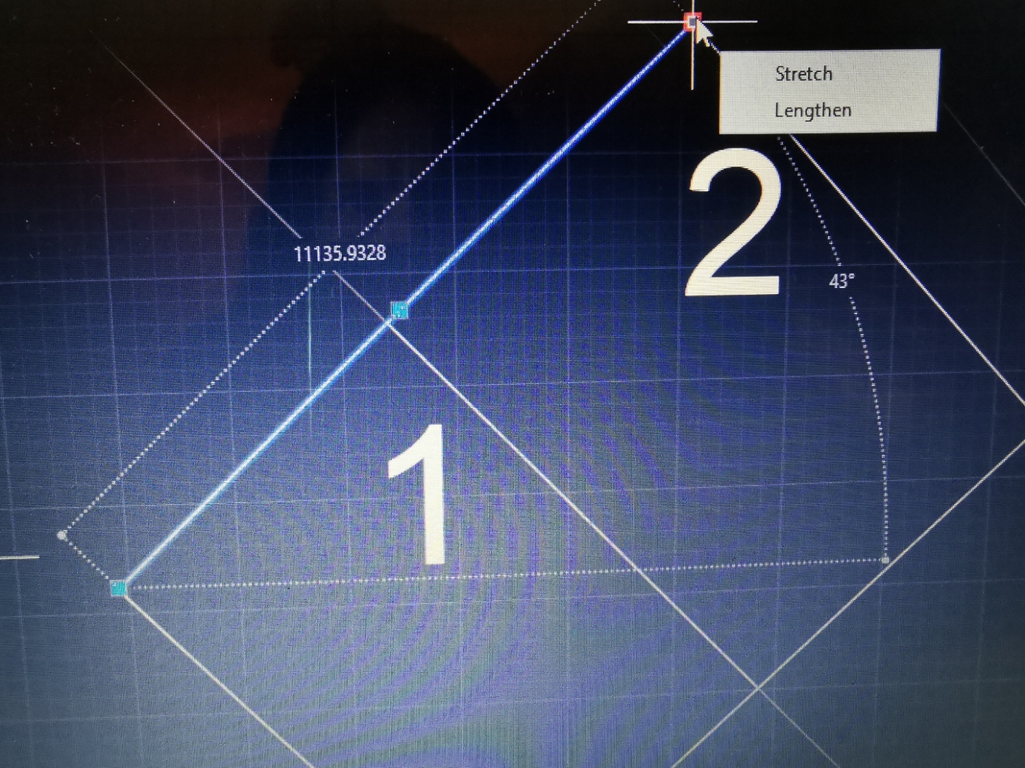

see attached pic. houses 1 and 2 (not plot 1 and 2) measure in the drawing at 11135mm.
using google maps (not the most reliable I know) I get a real life distance of 11730mm.
so lets just assume that the readings in the drawing are correct in mm.
Message 16 of 26

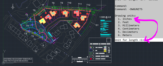

"units"? DWGUNITS command shows the file you posted as being in inches, that command is the one to use to identify what units in the file are meant to be.
T1 blue circle radius in the file you posted measures 1625.2610 in your posted DWG file.

>>>...houses 1 and 2 (not plot 1 and 2) measure in the drawing at 11135mm. ...<<<
11135+ inches in your posted DWG file.
Message 18 of 26
oh dear * shakes head* yes I see now. You are correct obviously. hhhhhhhhhh... dammit.
