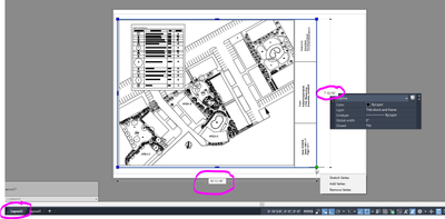

I hope I can explain this. I am putting large apartment complexes into CAD. I scale the drawing at the beginning and all measurements are true. When I put the plan into paper space and scale it using the Viewport Scale from the Application Status Bar, so it fits in the viewport. I make sure the scale does not change when plotting. Here is the issue- when I print the plan and measure a known distance with a ruler, it is not true to the scale in AutoCAD. The scale I used to make it fit was 1/64" = 1 foot. So this means that there are 64 feet is one inch, right?  Yet, when I measure on the plan a parking space that is supposed to measure 9 feet is measuring 3/8" which, according to the scale is also 24/64" which is supposed to represent 24 feet. Why is this happening?

I want to add that when I add plot scale 1/64" = 1 foot to the plotting dialogue window I get a blank drawing when I use extents, display or layout.

Here is a screenshot of the scale and the drawing.
Message 5 of 18
chezronify
Here is a screenshot and the scale.

I see in Layout2 your outline is only 7-15/16" tall and 10-11/16" wide, that is no where near close to 24x36 PDF output that I see you have opted to use in PLOT command, did you by chance miss that? See below
I suggest you delete the layout and start over, it is just messed up. Once fixed, it looks like this now

Thank you. As I said, I am new to this, even though I did it in school a few years ago. No one in my office does CAD so I am trying to figure it out. 1/64' = 1' was the scale that allowed the drawing to show best in the viewport. I tried all of them. It would be so much easier if there was someone here I could ask. As it is I just continue to make mistakes and I am very frustrated. I will try to make sense of your explanation.

Thank you for your explanation. How do you think this happened? Did I need to set it up better in Page Setup Manager? What did I do to make the size of the viewport so small?  How come the paper size is not 36" x 24"?

I hope someone else chimes in as to why my paper size is 36 x 24 and my viewport is small? I guess the paper size was 8.5 x 11 and that is why my viewport is so small.  When does Page Set Up Manager come into play. At what point in drawing a plan so you use Page Set Up Manager?

I hope the attached modified dwg file will help you.
I've setup the typical architectural paper sizes used: Letter, Tabloid, ArchD & ArchE.
I used Page Setup Manager to create the different setups and then set it to I want current in each layout.
This way I can have multiple settings and by just changing the page setup or creating new ones, I can apply them quickly to various layouts.
As the paper size gets bigger, the arch scale blows up so for Letter size = 1/64, Tabloid = 1/50 (more like an engineering scale), ArchD = 1/20 (again engineering scale), ArchE = 1/16...
So the selection of the sheet size & obviously what you want to see will determine the scale to use...
see screen captures below:
