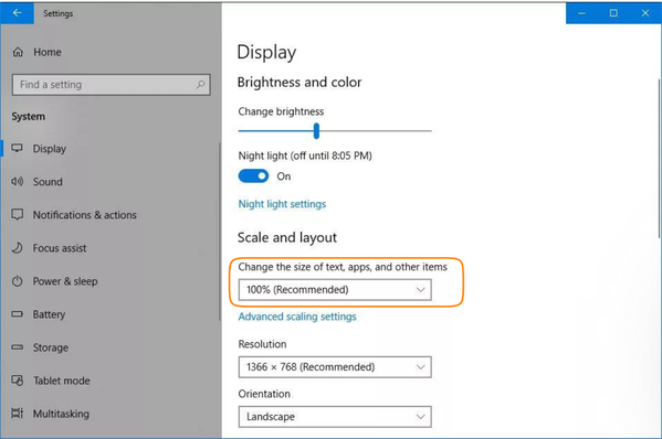

i cant seem to find out why my ribbons and layout tabs are cut off

Use the command "CUILOAD" and unload the ACAD CUI and again load it back by browsing. Does that fix the problem?
If not try updating your AutoCAD with latest update that might fix the issue.

Neither worked.

Try resetting your AutoCAD to defaults and see if that's fixes the issue. Here is how you can reset AutoCAD to defaults: How to reset AutoCAD to defaults

hi@Anonymous
The reason for your issue is because the windows True Type font size is too big.
  1. Enter Windows + R
  2. type 'Font size' then you will see 'Make font size bigger'
  3. Set the Font size as default then you will see all the fonts from the Ribbon.
If you would like to have bigger fonts, don't change the setting for font only but also the general display scale setting from Display;
