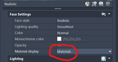

At the command line, type:
visualstyles
From there, select the 'Realistic' image, then select the drop down list for 'Material display', which is located under 'Face Settings'. Change that to suit your needs.
