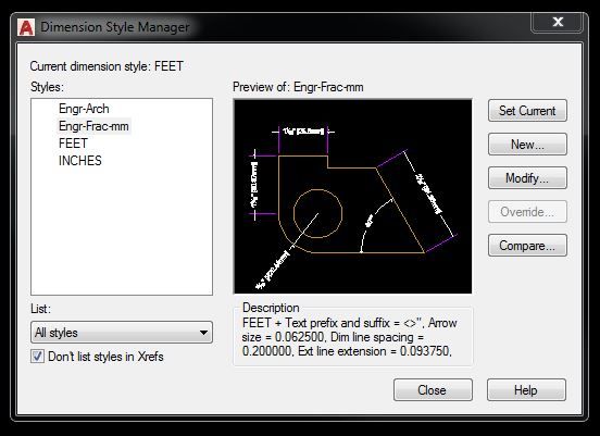

I have a Referenced Dimension Style somehow that I cannot get rid of. Now is this detrimental to my drawing, absolutely not, lol. This is just me wanting to know how to remove this dim style or what has it referenced. Is there a way to see how this is referenced or linked too? I have tried to purge and delete but it's referenced somehow, somewhere

Here is a .dwt file for example, am looking to get rid of the top two dim styles. File attached

There are two LFMServerProxyVolume objects that I can't seem to delete.  They seem to be the issue.

ara_neresesian
HI
I  can see Xref  in dwg ,
I think those two dimstyle belongs to the xref ,check xref file .
this is your  xref file name and address "G:\Detailing\Templates\Files to Outside Detailer\Template-Title Blocks\GD DT-BLOK2015.dwg"
send xref file to forum if problem not solved.

john.vellek
Hi @Anonymous,
I started dissecting your file to find the dimstyles.
First I copied the modelspace objects and pasted into a new file - no strange dimstyles
Second, I copieed the contents of your first layout over - nothing
Third, I copied contents of second layout - BAM!!! - there were the dimstyles. So, I moved that layout info into its own drawing in modelspace and purged out the dimstyles.
I didn't go further but I think this might be the process to isolate where the dimstyles are living.

Hi @Anonymous,
When I used -PURGE>Regapps on your Xref file it was able to remove 50 apps.
At any rate, I dissected the rest of your template file and created a new one (attached). Please let me know if this resolves your problem.
