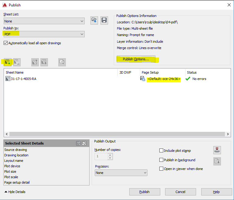

I have 30 pages of electrical schematics.  Currently we have 30 separate files, and every time we update it is a pain when we are converting to pdfs (have to open every file individually ,and then choose the window size, then print to pdf).  Is this the best way, or should all 30 pages be inside one .dwg file?

if i understand you right...you can prepare a page setup to PUBLISH all 30 files in one plot procedure.

PAGE SETUPS is the way to go, (even in model space)
Define the plot parameters and save it with a name:
Or right click on the layout tab (or model) and select Page Setup.
Then select NEW give it a name, select the name and then MODIFY
Then simply define the plot setting as you would prior to plotting (INCLUDING which plotter you wan to use) and select OK.  Then select that setup and set CURRENT.
Notice the IMPORT button??  That can be used in other files to import that setup from the current file and make it current.
Then use the PUBLISH command to publish an entire directory of files to PDF all at once.
The PLUS button is used to add other files to the list, under "PUBLISH TO" select PDF.
Under PUBLISH OPTIONS you can select single sheet PDF's or a multi-sheet PDF, include layers, etc. and a file directory location for the PDF's to land when created.  You can even SAVE the sheet list for plotting next time.
