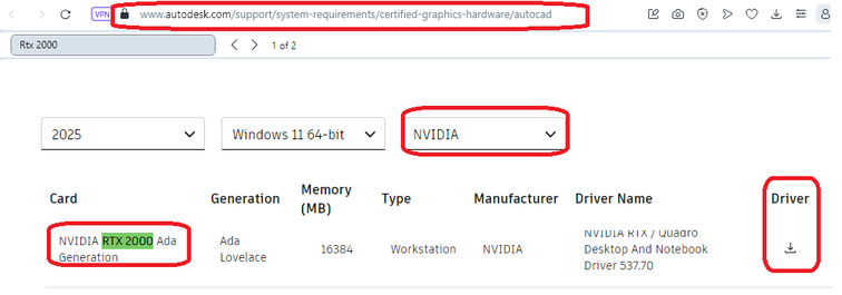

paullimapa
I assume you’ve installed the 2025.1 update?
Also have you tried downloading the certified 537.7 driver from Autodesk?

paullimapa
Click on the link I provided in my previous post which will take you to Autodesk certified driver website.
Then you filter out just for Nvidia and then scroll down the list to where your graphics card Rtx 2000 ada is listed.
The driver download is on the far right column.

Sorry for late, I tried it but it said "Compatibility doesn't work" What can I do for now?

paullimapa
As the site states send an email to Autodesk to notify them that the certified driver for your graphics card running AutoCAD 2025 on Windows 11 fails
autodesk.certification@autodesk.com
