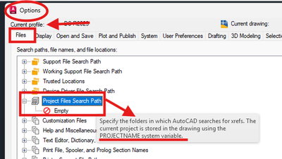

@ian Are you trying to use this feature/ability
