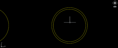

Hello, i having a issued and need some help,
I'm trying to revolve this piece on the Z axis
and make it something just like this pic,
but for some reason its unable.
I've never have this problem before and now i do, can someone help me out please?
Thanks.

click on below image and see if LOFT or Extrude commands can solve your issue .

Your profile is over the axis you are trying to revolve around. It can be collinear, or open but not past.

but i want it to lock like this
eligar_14_0-1603907477866.pngScreenshot 2020-10-28 125730.jpgScreenshot 2020-10-28 125621.jpg
the piece is not flat .

click on below image and try REVOLVE command after drawing an elevation for your revolved object .

Correct, @imadHabash said. Either select what to revolve about, or if you want to use a specific axis, make sure you dont overlap the axis.
