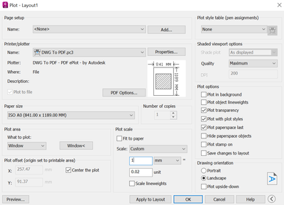

All of the polylines should have the same global width, should all be the same line as they were created with offset. They do show as the same on Autocad, But when I plot to PDF or even preview the plot some of the lines plot thicker than the rest of them.
I've tried Object Lineweights and Scale Lineweights on and off,
Any help would be appreciated.

rob_hawkesHH2E3
Zooming doesn't make any difference, and I have tired Adobe and Chrome to view the PDF and its the same, and always the same lines that are wrong. I'll try printing a physical copy when I can but I don't have access to a printer atm.

rob_hawkesHH2E3
Sorry I was getting clearance from higher up. And as I suspected due to GDPR I cant send what I'm working on but I've just done a blank drawing and done the same thing, Draw PLine, offset several times and plot and that gives the same results.

as Pendean said, change the printer/resolution
for example:
And re-think your visual check:
Your offset between the lines (on paper/pdf) is less than 0,3Millimeter, the width subtracted ~0.17 Millimeter!
That's far away from a useable practise (on paper).
Sebastian

rob_hawkesHH2E3
Hmmm ok that seemed to be the problem, is there any way of fixing it in the larger drawings?
Message 15 of 20
cadffm
? You picture and pdf looks well
Your both .pdf are print to A0,
and the object size "on Paper" on 'drawing-layoutwindow is bigger than the first -there is no problem!?
(If you printed the objects smaller the problem would reappear)
Paper more large and/or objects (on "paper") more smaller => you need more resolution

Message 18 of 20
rob_hawkesHH2E3
Changing it to AutoCAD PDF High Quality has done the job.
Thank you for your help.

rob_hawkesHH2E3
Changing the printer/plotter setting from DWG to PDF.pc3 to AutoCAD PDF (High Quality Print).pc3
I guess it was a plotting resolution issue.
