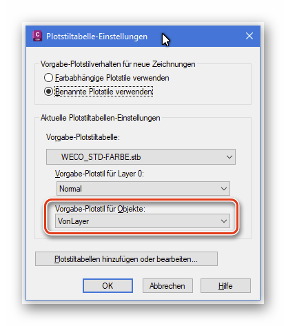

I thought that this would just be a setting in the options, but there the default is already set to "ByLayer":

Okay, I'm an idiot - in the plotstyle-tab (settings, when nothing is selected), the plotstyle was set to "Normal".
Once I've changed that to "ByLayer", everything works normally.
