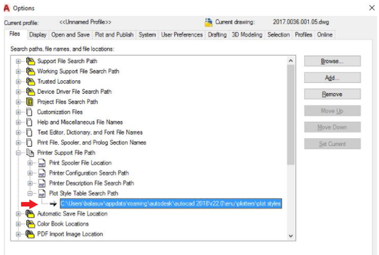

Can someone help me with this issue? I'm trying to pdf my cad file on my laptop (window version autocad trial version 2021) and the plot style is not working. The cbb is not missing...All the lines are colored, it doesn't follow the ctb. For a test, I open the same cad  file in my other laptop (Mac autocad LT 2021) and trying to pdf it, it comes out right. Couldn't find any blog or forum that mentioned this problem...I guess it may be something regarding my laptop configuration but I really don't know  or any variable I should use? Please help.

Make sure both versions are pointing to the "same" CTB path and you are selecting "Plot with plot styles".
See link: To install plot style files (CTB and STB) into AutoCAD

Post your plot style table and a DWG file where it has no effect, lets see what else you might have going on.

Your plot style table is behaving as you have set it to act:
COLOR = USE OBJECT COLOR
Compare it to MONOCHROME.CTB and you'll see what you want vs. what you have
Message 15 of 15
thks you so much it works!!! I guess the ctb that i created had changed for some reason when I open the same file on my window laptop versu the mac laptop...because when I open the same file using the same ctb. , the mac laptop is fine.
