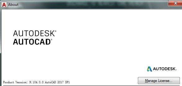

So for the thread opener: start AutoCAD, start command _ABOUT and compare your version information with that screenshot:
If your version is lower than the one shown in the screenshot please start Autodesk Desktop App, make sure you are logged in, let it search a few minutes for updates and then install them.

@Alfred.NESWADBA
I think you are right, my AutoCAD's version is much lower.
It is installed from intranet, not sure if it can be updated by individual.
Thanks for a lot. At least, I knew why I can't use that command.

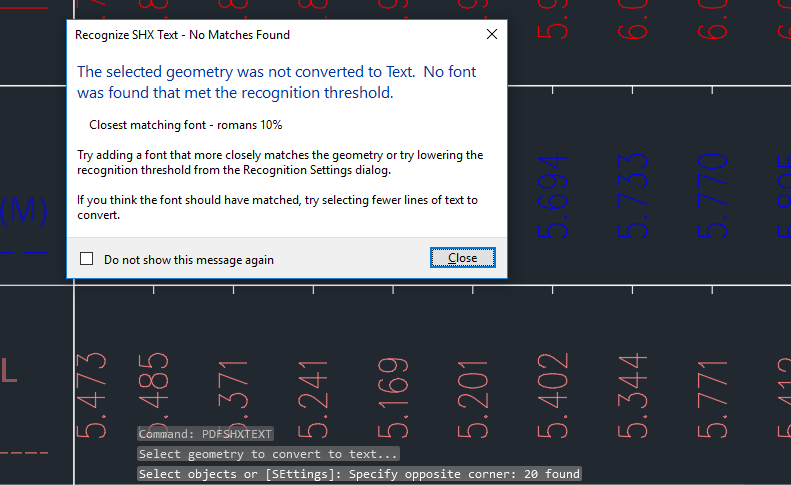

i was using autocad 2018 , i can't convert to the text, some one text will came on text otherswise can't converted the text. Below the Screen shot image is shownCapture.PNG
Have you seen the "Settings" option in the command-line within the command _PDFSHXTEXT?
This gives you a lot of options to define for how text can be recognized (or not):

yes i am used seems to this text and all, i selected iso,romans,simply text options, but the result was not get it......
Kindly tell us how to solved this problem....
