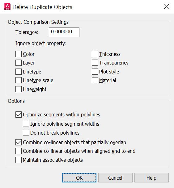

I'm trying to clean up a file with 400k objects with overkill but it does not work as intended. It does not recognize some objects that seem like exact duplicates to me. I extracted 2 such objects and attached here.
I've tried the following steps:
1. Run overkill with tolerance 0 and all boxes unchecked
2. Tolerance 1, boxes off
3. Tolerance 0, "ignore object property boxes" checked, "option" boxes unchecked
4-8. Tolerance 0, "ignore object property boxes" unchecked, "option" boxes checked one-by-one
The above steps do not work.
Steps that do work:
9. The checkbox combo that does delete duplicate lines but overall does a poor job because it breaks the polyline is "optimize segments within polylines" and "combine colinear objects that partially overlap".
10. Also, if I explode polylines, then run overkill, it does delete duplicates as it should.
But I want to keep polylines.
I can't figure out what's wrong with these objects.

>>"I can't figure out what's wrong with these objects."
OVERKILL is not a simple visual check,
1. this function compares the object data!
2. Your pline starting at different coordinates
3. Your pline vertic are in opposite directions
Picture, I colored the segement 1,2,3,4 in the same colors

What I mean is, by checking and unchecking the boxes in the Overkill command.
None of them worked. But if you download the LISP file and load it up like CADFFM said to do, the LISP file removes the Plines/ Lines you don't want.
See options image below. Once again, I checked and unchecked them all and it did not work like your post said. But to answer your question on exploding. If you explode what is in this drawing, Overkill works great. But you lose the PLINEs. So download, install the MYOVERKILL.lsp file and all works great like you want it do. The LISP uses the Draworder to keep the latest of the duplicates.
Hope This helps! If so, please click the “Solved” Button.
JRR!
Message 8 of 11
babicdusko
Thanks jreidKVSUZ,
I tried your LISP and it does work on deleting questioned duplicates. What it does not give is any customization over the process (tolerance) and does not give any results (how many deleted objects at the end). I want to delete only exact duplicates (tolerance 0.000). Does myoverkill command has any tolerance?
This combo does delete duplicates but at the cost of braking the polyline.
