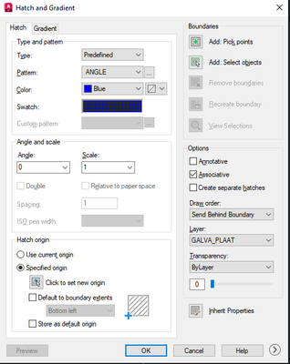

Up till yesterday my superhatch command grouped every image it hatched on the same use of the command so i could remove them together at once if i didnt like the image or so on
For some reason after i opened my laptop today, after using superhatch, on the same instance i use superhatch the images are not grouped and i have to group them myself afterwards.
EXPLANATION FOR THE IMAGE: The red part is the superhatched area, and normally they are grouped together since i used superhatch there once, but for some reason after i am done hatching the area it only selects one by one like the blue squared part (and gives me the option to invert or something with the arrow on the side but i dont need that, i need to be able to select all of it together after hatching)

Brock_Olly
When creating a hatch, go to settings (press T during the command) and in that window deselect the option to 'create separate hatches'.
Not 100% sure if superhatch has this setting because I only have LT.

cadffm
@Brock_Olly @paullimapa
Command: SUPERhatch - Images, not hatchs!

Message 8 of 10
202204003004
I apologize for not replying earlier. I have currently solved the problem by resetting all the settings to default and now it works as it did before. Thank you all nonetheless.
