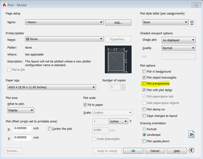

is there a transparency in play? you can select to not print transparency as well.

As @TheCADnoob mentioned, if the object is set to be transparent you might not see it in your display but per your PLOT settings it will show up if transparency settings are not selected.
