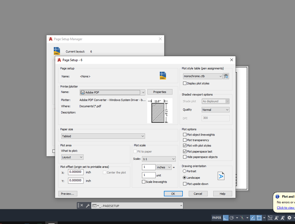

WBROWNMG7FU
In regards to me not being able to upload "PDFs", the files type says "Adobe Acrobat Document"
Message 5 of 9
WBROWNMG7FU
Yes I use monochrome on each page. I do not used default none.
Message 6 of 9
WBROWNMG7FU
Actually, maybe I am using default none!
What I do is open a new drawing in a file that already has the page setup completed. But I just noticed that on the publish command that the page setup is default: none. I assumed that if each individual page was setup that the setting would follow over when using publish. How can I change the page setup in publish?
my only option is to "import".
Message 7 of 9
paullimapa
this means you don't have a page setup created in the drawing and I see in your page setup screen shot window that it is set to <None>. So create and save a page setup which defines your plot parameters including monochrome.ctb then this page setup name will show up on the drop down list in the Publish window.
Paul Li
IT Specialist
@The Office
Message 8 of 9
WBROWNMG7FU
Thanks. This worked!
