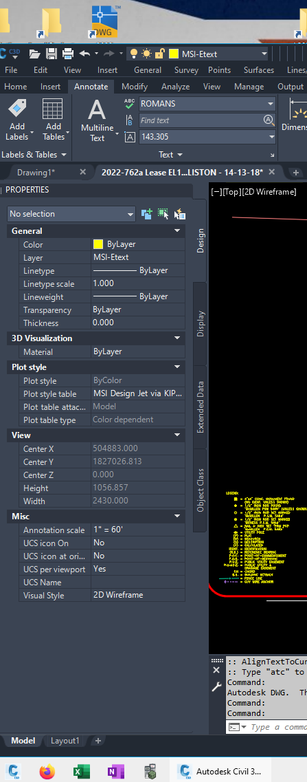

im searching and im finding the opposite issues or specifically the views of a drawing but thats not what im looking for
so far this hasnt been an issue until randomly this week i havent changed anything and yet somehow my open windows layout has changed. i want it to open multiple windows on the taskbar. not tabs or internal windows where i have to minimize inside of autocad i want to be able to switch by clicking the other window similar to the two windows shown in the attached picture.
i never changed any setting yet it somehow changed.  see the image attached what i dont want

heres what i mean.
- i dont want tabs
- i dont want drawing 1 to open just the drawing i click
- and if i open two i want two autocad things at the bottom
whatever helps. thanks

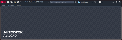

Ive tried all start ups and they all open drawing one separately. I have no idea how or why this happens.
Message 13 of 14
paullimapa
that's odd...both in 2023 & 2024 once I set SDI to 1 and STARTUP to 2 and I launch AutoCAD from the shorcut the program opens without loading a drawing like this:
