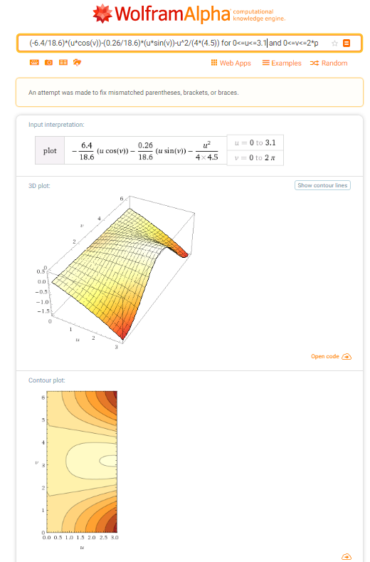

If you just want to enter math formulas and generate a shape, then AutoCAD is not the best program to use.
Wolfram-Alpha will take your equation and generate what you want.  If you go-pro, then you might be able to export the data in a form that could be input to AutoCAD as a point cloud.  If you want to do it in AutoCAD, you need to write a program to translate the equation in to a surface.  AutoCAD used to include such a program, called fplot.lsp as part of its bonus tools.
I used to use MathCAD.  Others use Maple or Mathmatica.
Here is a clipped image from wolfram-alpha
Architect, Registered NC, VA, SC, & GA.

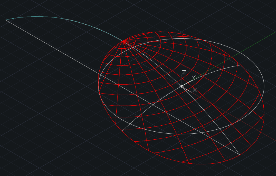

SEANT61
The parametric span on V (0:2PI) suggests a revolution.  If the derived data is plotted as such, the resultant geometry is along this line.  I set everything symmetrical about the XZ plane, though the derived data indicates a slight rotation off of that plane.  Conceivably, the rotation is needed but, maybe even more conceivable, I've got an error in my spreadsheet setup.  Either way, this is what I ended up with:
May your cursor always snap to the location intended.

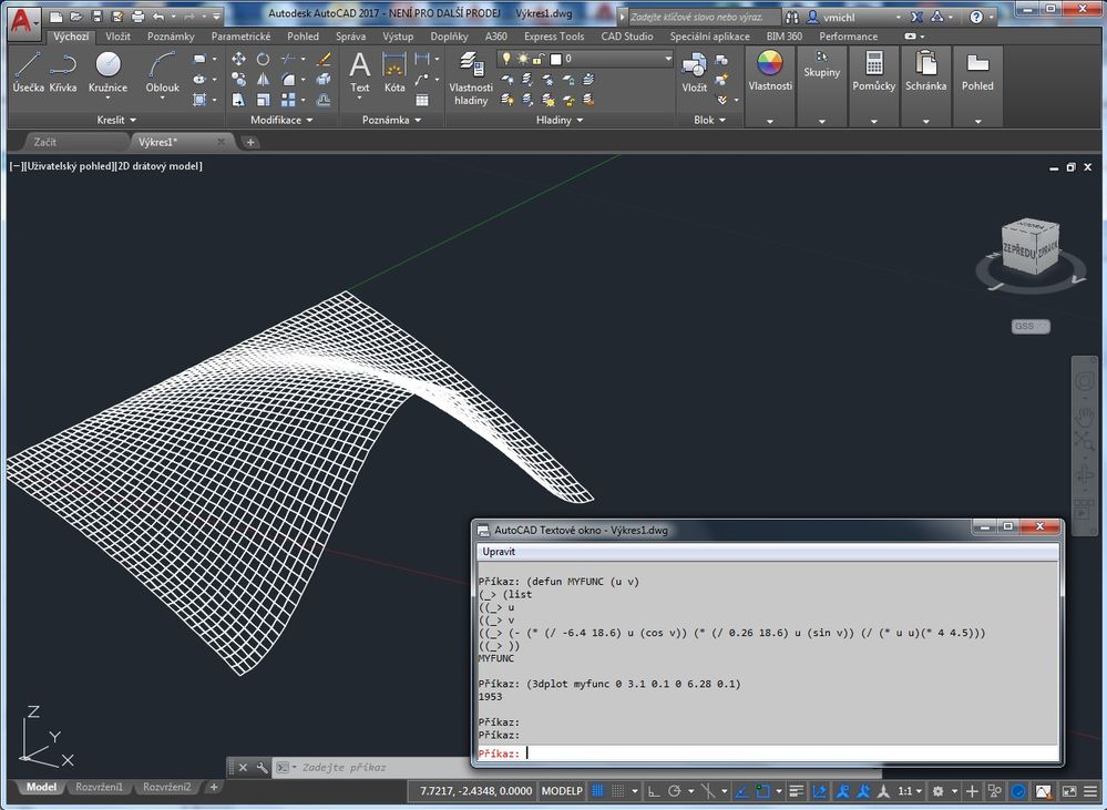

vladimir_michl
You can get the model also directly in AutoCAD. Just load our 3DPLOT Lisp utility, enter your function definition in Lisp and call (3dplot).
See:
http://www.cadstudio.cz/en/apps/3dplot/
(defun MYFUNC (u v)
(list
 u
 v
 (- (* (/ -6.4 18.6) u (cos v)) (* (/ 0.26 18.6) u (sin v)) (/ (* u u)(* 4 4.5)))
(3dplot MYFUNC 0 3.1 0.1 0 6.28 0.1)
You will get this:
Vladimír Michl, www.cadstudio.cz  www.cadforum.cz

Many thanks! It worked fine for me. I could open it and the model was correct.
Now I've got my point cloud and model in the same drawing.
Regards
