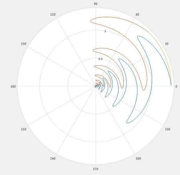

how can i model such a plot in autocad.
this plot what created using a mathematical formula ,demostrated in mathlab.

dim678
the colors have no meaning its just a contour
Message 5 of 18
dim678
i have only the points of the contour
i would like to create a 3d of the shape with width og 1 mm
is there a way?
But it's two contours.  The colors are not what I was wondering about, but why there are two of them.  Do they represent running the same equation twice with different values for something in the equation?  I don't think they can both be part of one result from the same equation.  I'm assuming the 'r' is the radius out from the origin.  As you step outward in small increments of 'r', you get different angle results [phi], and that's what's doing the sweeping back and forth.  But it looks like that equation would give only one angle result for any value of 'r', but there's one location on each of the two curves for any given radius.  They look like they might be exactly the same shape except for the greenish extension off the outer end of the brownish one, but maybe they're slightly different..
So what's alpha?  What's R-sub-zero?  [The outermost radius limit?]  What's tau?  What's ln?  That last one may just be mathematical terminology for some function I haven't encountered, though it may be clear from the source, but the others look more definitely like variables you plug specific values into.  Presumably this shape is the result of a specific set of values for those, and with different values the resulting shape would be different.
That's why two of us have asked for a link to a web page, in hopes of answering these questions.  It might be comparatively simple to generate the same curve(s) in AutoCAD, along which you could Sweep or Extrude something, but not without those answers.

dim678
Hello,answers to your question are as follows
"Do they represent running the same equation twice with different values for something in the equation?"
each curve has a different formula but the input values are the same.
"So what's alpha?  What's R-sub-zero?  [The outermost radius limit?]  What's tau?  What's ln?"
ln is a logarithmic function , alpha and R  are just constants which i put in the formula,basickly"
basically i can get the polar coordinates of the contour,what should i do afterwards.

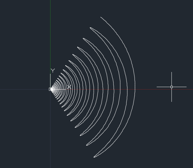

That long line is the conversion of the formula into AutoLisp terminology.  'R0' is the outermost extent, 'inc' is the size of the stepping increment in radius between calculated points in the Spline.  This is the result of using that with these arguments:
(wavy 1.5 0.001 1.0 1.4)
and looks pretty similar to [one of the curves in] the image:
I leave it to you to fine-tune the arguments to get a shape more precisely as you want it.  You can use a polar Array, or Copy it in place and Rotate one of them about 0,0, if you need two as in the original image.

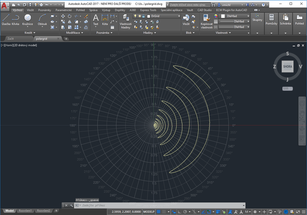

You can also spice up the output by superimposing the resulting shape on an automatically generated radial grid from another freeware add-on - the DrGrid utility - see http://www.cadforum.cz/cadforum_en/drgrid-parametric-grid-for-autocad-drawings-tip9829 - like this:
