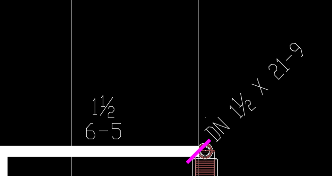

Hi folks, after a few weeks of searching and google not returning a single answer that's even similar, I've decided to ask the question here. I work for a sprinkler company, and we use a LISP overlay that mimics our industry standard from old drawings showing stacked text like in the screen capture I have attached. I can't seem to find a way to make a dimension style that will suppress the (') foot and (") mark while still being in Imperial feet and inches. Any help would be greatly appreciated. As a usage note, my QA department requires my drawings all look like this, but it's a pain to make every drawing using the lisp overlay, as it creates a lot of extra steps for making the drawings stylistically correct. I can save almost an hour of drafting per drawing by just using standard AutoCAD commands, and make fewer QA remarks, but doing this basically makes my dimensions disassociated. So, basically, if I have to go back and edit the drawing, I have to redimension everything on top of making it look the "right way". This is more about time saving then anything. Thanks in advance!DimExample.PNG

The only way I think that could be done would be with a routine that would take a Dimension and create override text content  in the form you're after.  That would have the same drawback that if you Stretch something, the text content would not  update, and you'd need to re-run the routine on all affected Dimensions.  But it could at least make that happen very much faster than overriding manually.  I picture two routines -- one to include, in one command, drawing  a Dimension and  immediately changing its content, and one to just change the content of selected Dimensions for updating.
But come to think of it, here's another cockamamie suggestion:  Make a Text Style  in which the foot and inch marks are defined to draw nothing, and assign that to a Dimension Style dedicated to only this kind of thing.  I don't think that would be difficult to do, if it sounds like it would serve your purpose.

dbroad
Most consistent and reliable approach would be to make a copy of the txt.shp font file and to rebuilt the " and ' characters to be just 1/4 of a space. Then compile it and use that font for your dimensions. Skip lisp files and dimension overrides.

THIS!!! This right here. Judging by the look of it, it's exactly what I was hoping for and an option that works!!! That it can't be an option (I'm barely a drafter, let alone a coder!) seems a little absurd, since you can suppress and change nearly every other aspect of the dimension string. As a work around though, this is the best option. I'm not sure how many others it will help, but it helps me tremendously and for that, I THANK YOU!!!dimperfect.PNG
