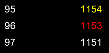

Now, if there is an error in the sequence, for example, need add 1 to all numbers after A:24-48, ie. A:24-48 becomes B:1-1, B:1-1 becomes B:1-2, etc. We can use the second formula to convert texts into original numbers first, then use steps above to convert numbers into "A-24-48" format again.
Step 2.1, remove all prefix with FIND command
Step 2.2, the result of Step 2.1:
Step 2.3, Use ALTEXT and load Formula 2 to convert these texts into original numbers.
Step 2.4, Use ALTEXT to add 1 to all numbers ≧ 1152.
Step 2.5, the result of Step 2.4:
Then repeat Step 1.2 to Step 1.5 to convert the numbers into "PT.PT1.A:24-48" format.
