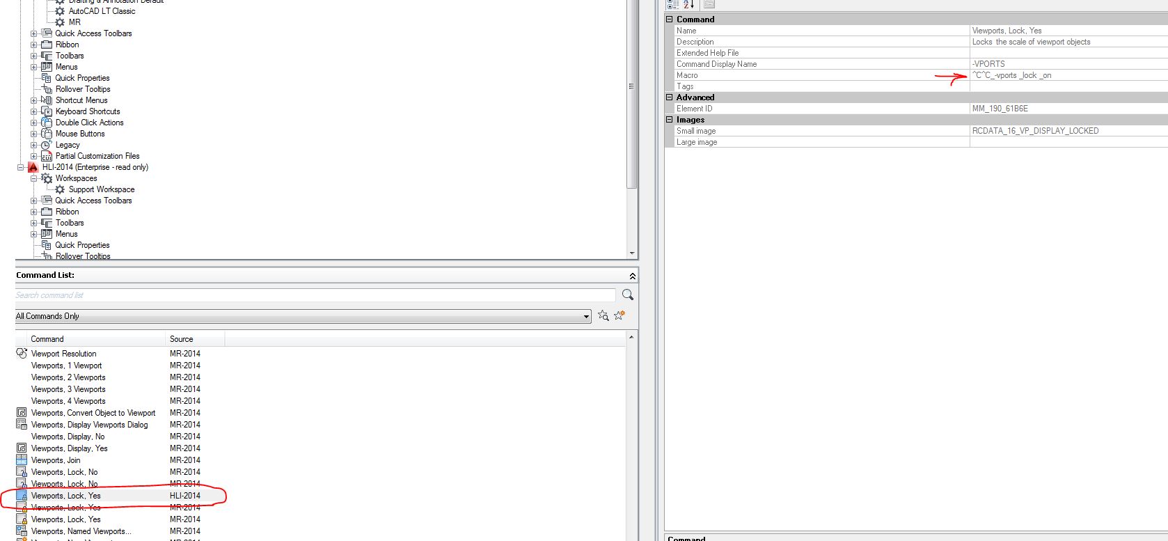

m_rogoff
^C^C_-vports _lock _on
This macro is built in with AutoCad, just add the command to the Viewport toolbar
But that doesn't lock all Viewports in the drawing, as originally requested.  In older versions, it leaves you with a prompt to select objects, which means not only that you need to do that selection, but that you can lock only those in the current Layout, and you need to get into each Layout separately to do so.  In newer versions [I'm looking at the description in Help, since I don't have a newer version where I am at the moment to confirm it], it says it locks only the current Viewport, and no mention is made of either an On/Off choice [though I expect there must be one, because it doesn't list an Unlock option] or a selection.
The AutoLISP approach, on the other hand, will do it to all Viewports in the drawing at once, no matter how many Layouts there are or how many Viewports there may be in any of them, without the need to get into each Layout, much less do anything in it, such as invoke the command or macro, or select the Viewport(s).

rflach1
Best answer. This works great. I appreciate all the Lisp coding suggestions, but for a straight answer this is the best option. I will hopefully get to a point where I can start coding my own items.
