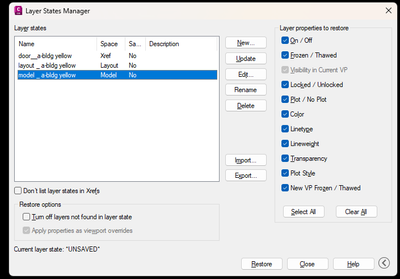

Additionally, it isn't due to any other checkboxes in the layerstate manager. This is what my manager looks like:
You are right, but
And you posted a screenshot with 95% options hidden 😆

EliANewlines
sorry about that, see image of layerstate manager with all option showing:
Message 13 of 23

When the layerstate is created by using the "edit" option in layerstate manager, then it doesn't work. It only creates the fake xref overrides that don't show up in layer properties. However, when the layerstate is created by first making xref overrides then creating the layerstate (which by default takes the current layer properties), then it keeps the overrides and applies real xref overrides when it is restored.
My layerstates were made using the "edit" menu, and your layerstates were made by taking the current layer properties which already had xref overrides.
It's unfortunate that the "edit" menu is practically worthless for xrefs because of this bug, but it's something I can work with. I'll just make my layerstates the other way.
