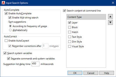

ВeekeeCZ
Consider using the command line to set the current layer.
Possibly this setting...
Then... just typing oran... to get...
