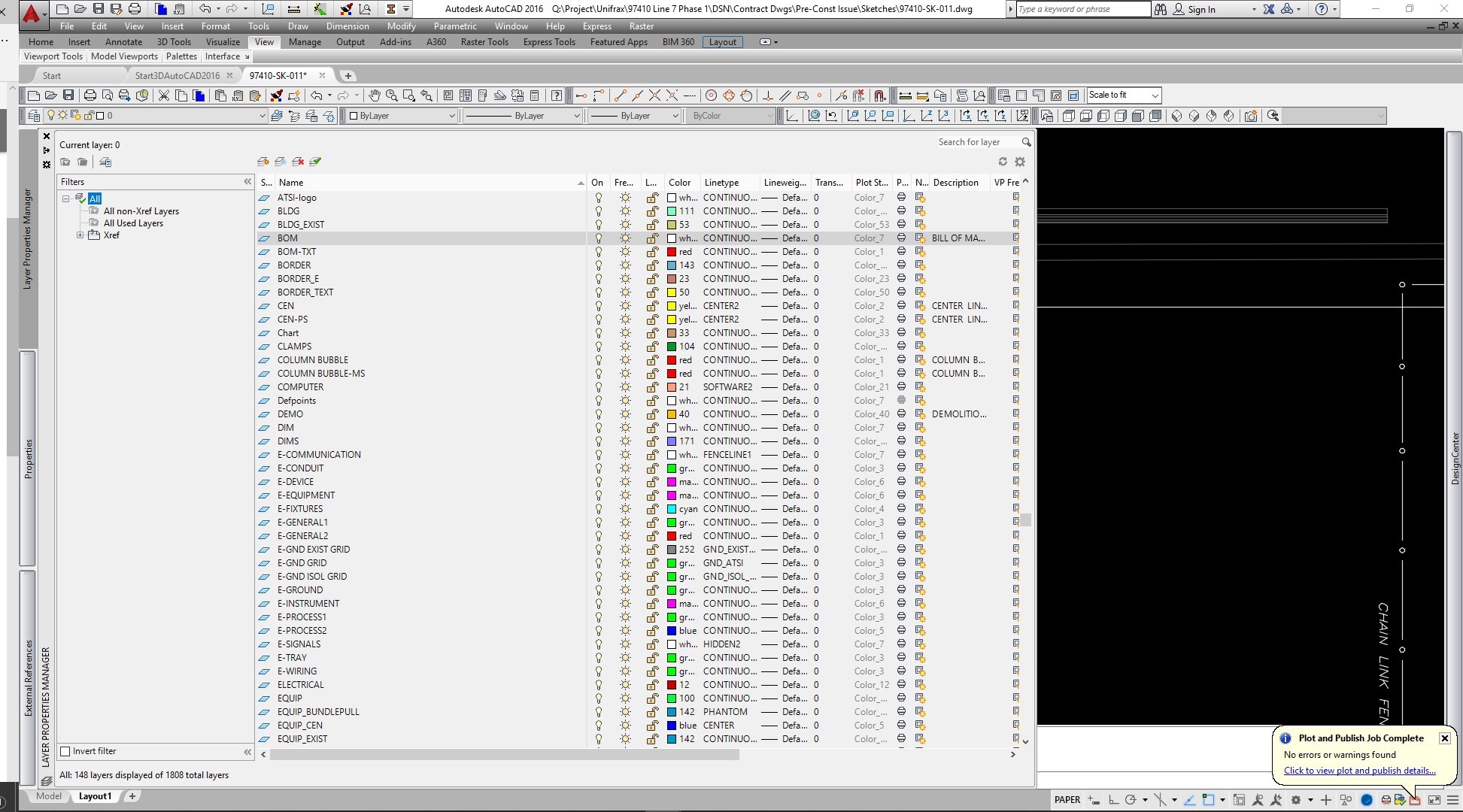

  Hi Everyone,
    I am working in AutoCAD 2016. If I have no XRef's in my model, I look at the Layer Properties Manager and the Layer Control Pulldown in the Layers Toolbar and all of the items are in Alphabetical Order. When I Xref certain Models, the listing is fine in the Layers Properties Manager, but everything is out of order in the Layer Control Pulldown of the Layers' Toolbar. Please see attachments...
    How do I correct this? Is there a command to tell the Layers Control Pulldown to list in Alphabetical order?
    thank you,
                      Patrick

Hi @Anonymous   Make sure the MAXSORT variable is set to a number higher than the number of layers in the drawing. I see over 1800 in the image. Maxsort can be 0 to 32767.

Thank you so much, user181... That was the issue! Maxsort was set to 1000. I changed it to 21,00...
     sincerely,
                      Patrick
