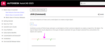

I am trying to join the two diagonal lines pictured here into one polyline.  I have redrawn these two lines several times (snapping to the endpoints/intersect points of the grid) and find that while the PEDIT command works consistently, the JOIN command has worked on only very rare (albeit some) occasions.  I would like to understand why this inconsistency is occurring.
I notice when I zoom in extremely close that the endpoints of the lines are not actually touching, but I am using OSNAP to the intersection of my grid and the LIST command says the two lines share a common endpoint.
I have found some work-arounds for these particular lines, but they are not sustainable in the long-term if working with many lines across a large file.  These little “cheats” were:

@jw-2024 If you see a gap, fix it with FILLET command before you start JOIN. Or as you discovered, PEDIT is better at the task. Always know the other ways to get something done. And always look things up in HELP in the program, in this case notice how their example does not look like your objects
