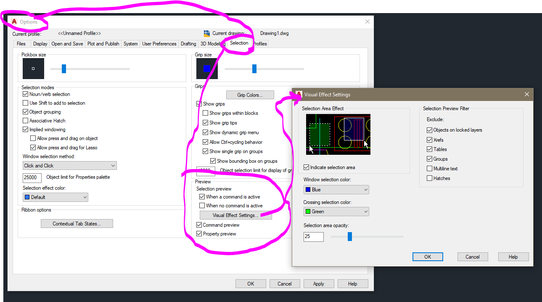

I've been using AutoCAD 2021 on windows. when  I use the Area command -> Add -> and start to select the shape (not object or polyline), it would always turn the selected boundary green to show what is being calculated but it won't show in my version so it is very difficult to know which boundaries I already selected for adding them up.
Note: in AutoCAD 2018 it was working proprly.

Not doing it here: do you have the 2021.1 update installed? ABOUT command will confirm it.
In both 2018 and 2021 start OPTIONS command, go to the SEELCTION tab, then check that both PREVIEW and the VISUAL EFFECTS SETTINGS button pop-up have the same settings established.

No, I meant this in OPTIONS
