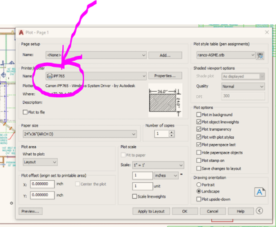

1) Post a screenshot for the PLOT command pop-up that created that preview please.
Where are using AutoCAD 2021 not AutoCAD 2020.
