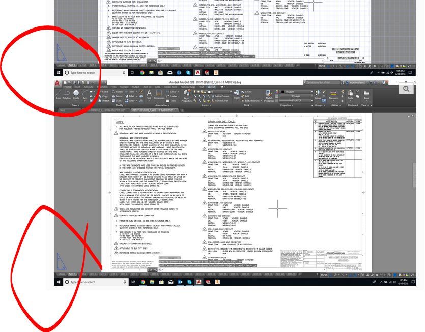

A drawing I am working on has a "Border (ANSI)" layer in the drawing that contains the border and most of the title block.  However, the first sheet of the drawing only shows some of the layer.  It shows basically just the words for the layer but nothing else.  All layers are thawed, unlocked, and view port thawed.  The other sheets after the first one are fine and show everything they are supposed to, including the border.  Also, if I copy the border and setup from a different drawing that has it done properly, when I paste it onto the first sheet of this drawing, it only shows the words still and not the border and lines, even though they were selected and copied.  I've attached a picture of the first page on the drawing that's broken and a picture of the first page of a drawing that's not broken so you can see what is missing.  Nothing appears to be turned off or hidden and it seems as if the border is there, just not visible or interactive.Screenshot (2).pngScreenshot (1).png

Hi @Anonymous,  When in that layout tab and in paperspace and not in the viewport look at the VPFreeze column of the layer manager and see if the layers are frozen there.

Double click inside the viewport of 1st sheet to activate the viewport, type in VPLAYER, then T for thaw, enter a *, then hit enter key  a few times.

Hi @Anonymous,  Where is the border? Paper or Model space?  If it's in paper go to the tab with the missing layers. Go to layer properties manager palette while in paper and not inside viewport. check the VP Freeze column. Then double click inside viewport and check same column.

Since all we can do is guess I now say the border is a block separate from the remaining title block text and you accidentally erased it in that layout and you can just copyclip & paste from another layout

Or Border+Text(Attributes) and Title is ONE Block and the scaling is very small,
the attributes are not synced with the current blockdefinition.
@Anonymous
If all three items are part of ONE block, select the title-Text and check the X/Y scaling factor.

Just got off the phone with support.  Turns out the block itself had no geometry and was completely undefined.  I had to purge the block from the document and then find a drawing with the proper block and bring that in.  My guess is whoever worked on the drawing before me deleted something from it and didn't have the knowledge to properly fix it which resulted in an improper title/border block.
