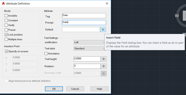

To put this in a block with an attribute, use the ATTDEF command with a Field
And then add the attribute to a block.
