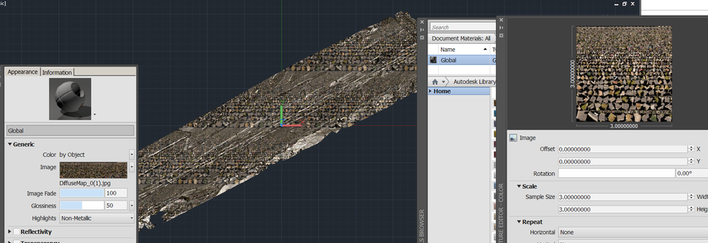

I apologize for the delay but I have actually been exploring this issue all morning long.  I have found FBX formats newer than 2009 do not work well at all.
So I am currently working with a 2006 binary format FBX. It imports into AutoCAD very quickly with one material as expected. This is the Global material. I open the Material Browser to edit the Global material. I click image and apply the Texture that @Alfred.DeFlaminis gave us earlier.
Now the big question is on scale of the sample size and whether or not it should have any tiling (I suspect not).
I also think that this original file had Normals issues which might explain why this texture is not applying correctly.
With the newer format FBX I went through the same process but then also had to drag the Global material onto the model for it to display.
I am not sure that I am going to get any further on this as from what I understand, the FBX file itself has some errors in it that would need to be corrected. I hope though that this steps might help you to get where you need to be on this process.

add image to global. texture editor. turn off tiling. link texture transforms. no link texture transforms (just adds image on top. not desired result)

I have not had success with this process because I feel that the original FBX file has too many issues as pointed out by @Alfred.DeFlaminis.
As I also indicated, there are known issues with AutoCAD and newer versions (more current than 2009 format) of FBX files.  I did have moderate results when the FBX file was saved as an older version but without knowing the scaling of the texture that is applied to material there isn't much else that I can provide.
Alfred.DeFlaminis also pointed out that he thinks the import into AutoCAD might be disregarding the UV's from the file coming out of 3DS Max.
So, I don't have a fix for you. When a clean 3DS Max file was created from scratch ,  a material applied, and then exported as a 2009 binary FBX file, it imported correctly into AutoCAD although the texture still had to be applied to the material.
