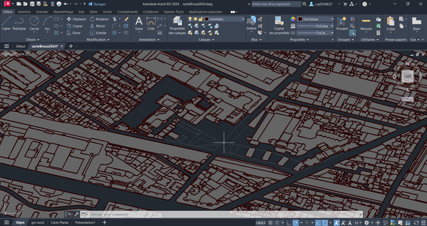

I would like to import a file into my AutoCAD drawing.  For my case, it is the built plans of Paris, a point cloud and 2D vectors.  Only the file appears as follows in my drawing space.  Should I convert my file to pdf or dwg format or is there anything to do to open the file?

I read what was written to me yesterday.  I then installed an application "reaConverter 7" because mygeodata pays if the file is more than 5MB to convert a geojson file to dxf.  Once imported everything works fine!
I don't know the extension you're talking about other than TerryDotson but it could be interesting.
No, possibly the only problem with the file lies in its tracing.  It has many hatchings.  Do you know how I could easily remove them? I want to have only the vectors as around the cursor.
